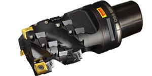

CoroMill® 690 – Developed specifically for high-productivity 2D profile milling of titanium components
Inserts are securely fastened by iLock™ technology. By equipping every insert pocket with threaded coolant holes with nozzles for high-pressure coolant delivery, you can apply maximum coolant where required.
CoroMill® 690 – The cutting edge for titanium milling
