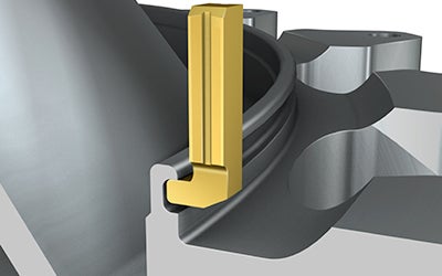

CoroCut® angled inserts to fit any groove shape
Designed specifically for reaching difficult-to-access grooves and pockets in complex components. To complement the standard CoroCut 90 degree program, blanks are available in 90,45 degree and T-shape for more specialist requirements.
