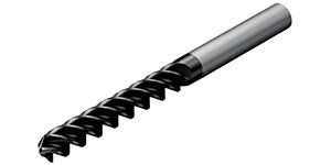

CoroDrill® 863 with -O geometry – solid carbide drills for high-quality hole making and longer tool life in composites
Hole making in CFRP (carbon fiber reinforced polymer composite) – facts and demands
- Minimal delamination of fibers
- Good surface finish and dimensions
- Unidirectional or woven layers
- High rate of material removal
Solutions
- CoroDrill® 863 with -O geometry, standard diameter range 3–9.5 mm (0.118–0.374 inch)
- Drill depth 3–10 × drill diameter
Benefits
- Enhanced tool life – more feet of composite material drilled
- Excellent hole finish and tolerance
Cutting data
- Visit CoroPlus® ToolGuide for precise cutting data suggestions
