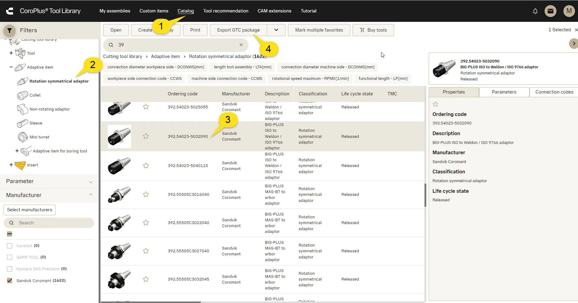

Find and export a standard item
  1. Navigate to the Catalog page in CoroPlus® Tool Library
  2. Select your desired tool type (for example: rotational symmetrical adaptor)
  3. Find a product similar to the custom product you want to create. You can use filters or search options to narrow down the results.
  4. Select a standard product and export the GTC package.

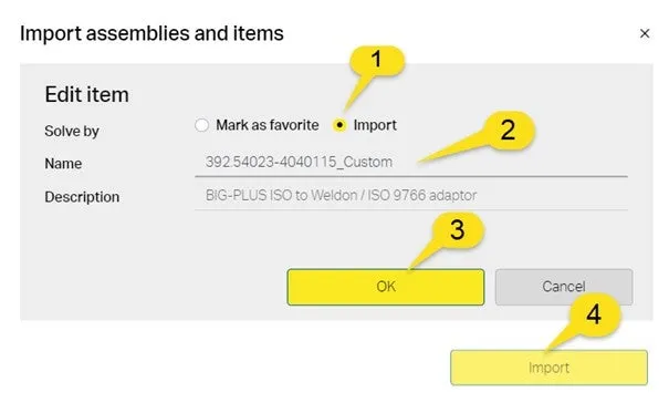

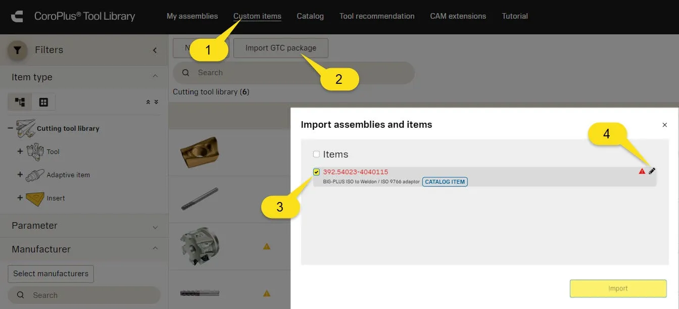

Import the exported product
  1. Navigate to the Custom items page in CoroPlus® Tool Library.
  2. Select Import GTC package and select the GTC package you downloaded in the previous section.
  3. Mark the item(s) you want to import.
  4. Use the pen icon to edit the name.
The item is already in our catalogue, so you must assign it a new name.
  1. Mark the Import radio icon.
  2. Modify the Name of the items. You may modify the description if needed.
  3. Press OK.
  4. The Import button will be activated once you press OK - press Import to import the item.
     5. Close the window when the import process is completed.

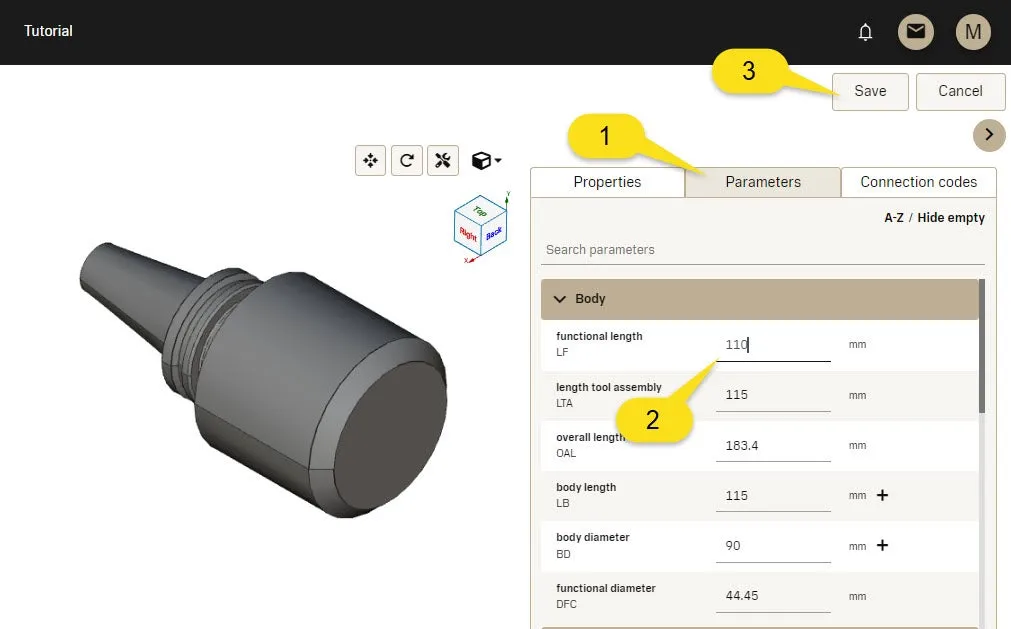

Edit parameters
To change the parameters, open the imported item:
  1. Select the parameter tab.
  2. Modify parameters based on manufacturer-specified values.
  3. Do not forget to save the changes.

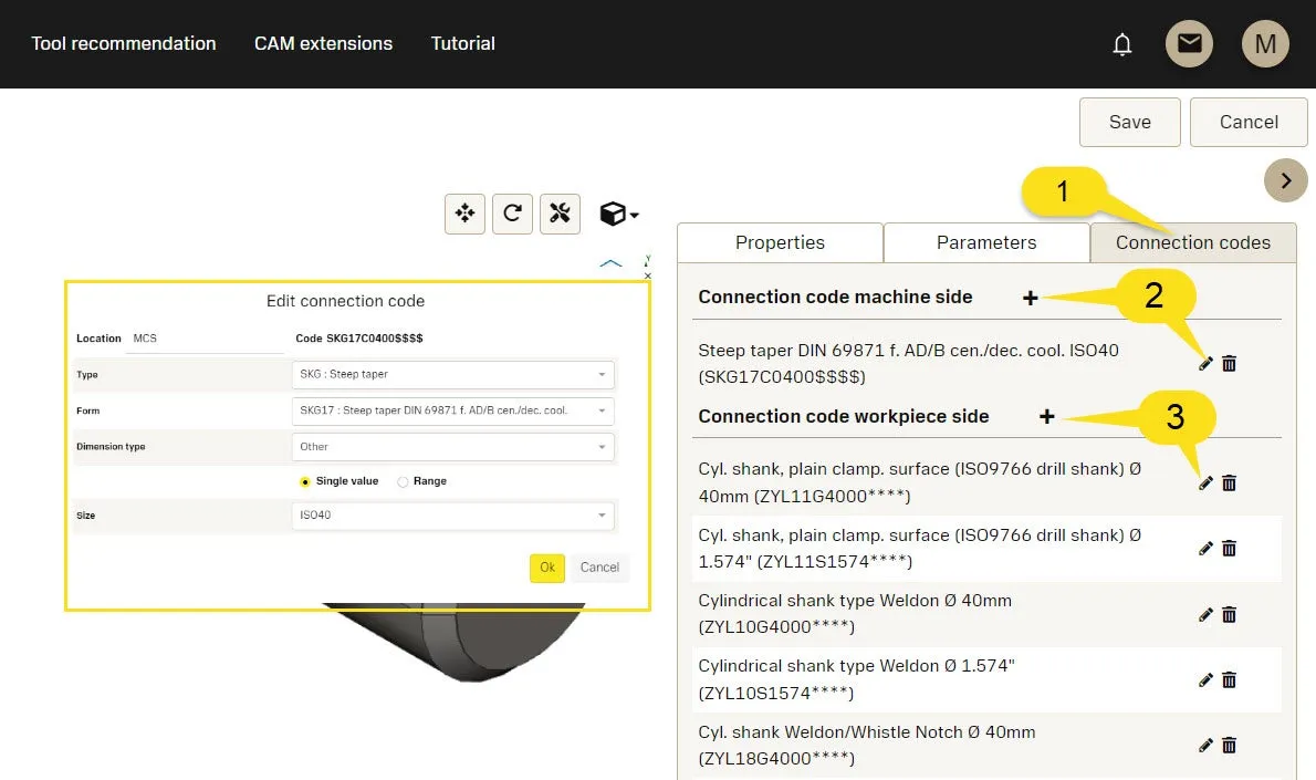

Add or edit connection code
  1. Click the connection codes tab.
  2. Add new or edit existing connection code for machine side interface.
  3. Add new or edit existing connection code for the workpiece side interface.

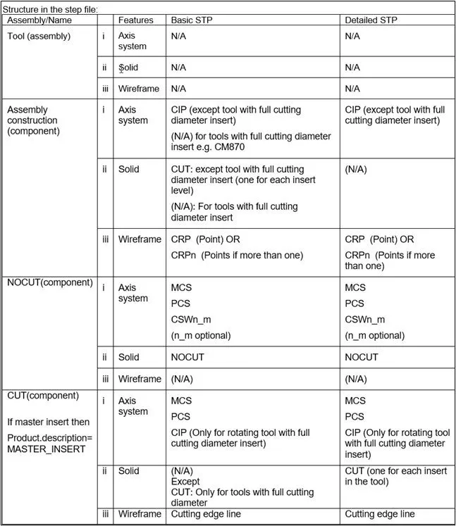

Requirements for a 3D model
For CoroPlus® Tool Library to create an assembly and generate essential information for the GTC package, like 2D drawings, 3D models, and assembly pictures, it requires at least one accurate model (3D model detailed or 3D model basic). We suggest using the '3D model detailed' if it is available.

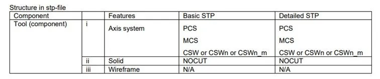

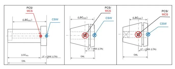

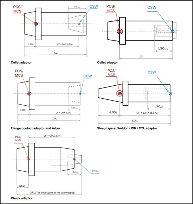

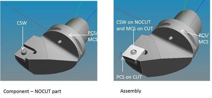

Adaptive items
Adaptive items should contain named coordinate systems (PCS, MCS, CSW) and solid items should have the name NOCUT.
The position and orientation of the different coordinate systems are shown below:

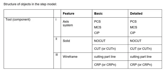

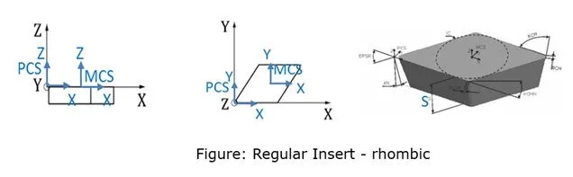

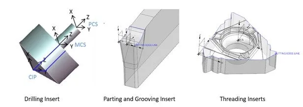

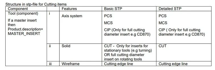

Insert items
The requirements for the Insert step file are listed below. It is important to set the name (CUTTING EDGE LINE) for the cutting profile because CoroPlus® Tool Library uses that profile to calculate CRP and the necessary dimensions.

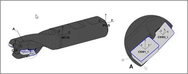

Indexable milling and drilling tools
Requirements on the 'Indexable mill' and 'drill tool' Step files are listed below.

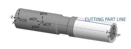

Solid round tools
The requirements for a solid round tool (STEP) are listed below:

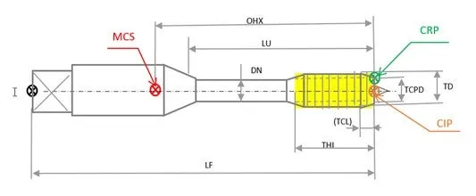

Taps and Reamers tools
The structure of taps and reamers is similar to that of solid tools mentioned above. Below is a parametric representation of taps and reamers, including essential information such as coordinate systems and CRP.

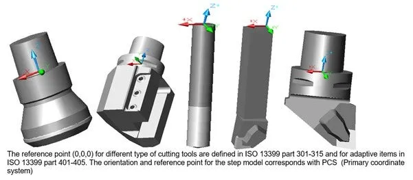

Reference point (origin) of the tools and adaptors
See below the reference point (origin) of the tools and adaptors:
