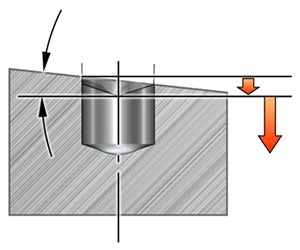

Drilling inclined entrances/exits
Generates uneven and excessive forces acting on the cutting edges
- Intermittent cutting as the drill enters/exits the workpiece
- Increases chance of vibration
- Can distort the drilling profile
- Causes more tool wear than conventional drilling
General recommendations:
- Stability is crucial. A small length to diameter ratio will help to keep the tolerances
- Milling a small flat surface is recommended when entering workpieces with a large inclination
Angled or inclined surfaces, entry
- Use shortest drill possible to minimize vibration tendencies and decrease the effects of deflection
- Start with lowest recommended cutting speed and 1/3 of lowest recommended feed (or lower) until fully engaged and then return to normal feed
- 4–5×DC the inclined entry can be angled up to 15º
- 6–7×DC the inclined entry can be angled up to 10º
Angled or inclined surfaces, exit
- Recommended start values for cutting speed and lowest recommended feed (or lower)
- 4–5×DC the inclined exit can be angled up to 15º
- 6–7×DC the inclined exit can be angled up to 5º
Drilling asymmetrically curved surfaces
- Use shortest drill possible to minimize the drill bending outwards from the center, similar to an inclined surface
- Reduce feed to 1/3 of the initial penetration rate for a concave surfaces
- Radius of curved surface should be bigger than drill radius
- Not recommended for 6–7×DC drills
- Maximum recommended angle from centre to corner is 6 degrees to ensure the tip enters the workpiece first
- Ensure stable conditions and use shortest possible drill
- Reduce feed to 1/3 of normal rate during entrance
- Make a pilot hole (preferably with short CoroDrill® 870) or spot-mill to create a flat surface if larger angle or longer lengths
