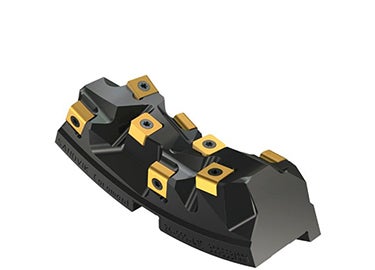

Internal milling
M641 (tangential mounted inserts) and M642 (radial mounted inserts) crankshaft disc milling concepts
This is a stable system with good process security, which provides an unrivalled cost efficiency. The different tools range from lightweight up to large tools for ship diesel crankshafts.
Concept description
M641 and M642 are crankshaft disc milling concepts with tangential (M641) and radial mounted inserts (M642).
The design developed for CoroMill® 745 (face milling) resulted in a new method for positioning inserts on cutters. This gave M642 greater chip room and greater number of effective teeth compared to conventional tangential mounted milling tools.
This new patent pending design results in reduced cycle times and better chip evacuation.
Customer benefits internal milling
- High stability and productivity
- Low carbide cost due to fewer inserts in the cutter
- Quick tool exchange and low tool weight
Features and facts M641/M642 Internal milling (I.D) tools
- Diameters ranging from 170 to 420 mm (6.693–16.535 inches)
- Widths from 15 to 100 mm (0.590–3.94 inches)
- Light weight solutions < 15 kg (33 pounds)
- Solid disc or segment solution
- Variety of segment mountings
- Various couplings for different machine tool makers
- Simultaneous machining of several bearings
- Tandem cutters
- The back face of the insert is protected by the tip seat with the new design
Coupling example
Coupling example
Internal milling segment
