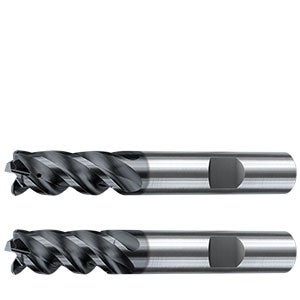

Product range
4 flutes: 2P342-PA / PB, 2S342-PA / PB
  • APMX: 2xD
  • Diameter range, mm (inch):
    2–25 (0.125–0.75), 3–20 (0.125–0.75)​
  • Grade: P2BM
5 flutes: 2F342-PD / 2N342-PD
  • APMX: 2xD
    6–20 (0.25–0.75), 6–25 (0.25–0.75)​
  • Grade: P2BM
4 flutes: 2P342-CMB, 2P342-MB, 2S342-CMB​
  • APMX: 2xD
    6–25 (0.25–0.75), 6–16, 6–20 (0.25–0.75)
  • Grade: M2CM
