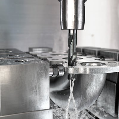

All-round hole making
With CoroDrill® Dura 462, you can expect predictable and trouble-free drilling across all materials. One drill for all materials ensures greater cost-efficiency and machine flexibility. Explore our extensive stocked standard assortment where you can find a drill for every need.

  • Strong parallel web design combined with large flute volume, enhances chip evacuation.
  • Features a geometry designed for excellent machining stability and process security
  • Maximum productivity thanks to grade X2BM
  • Fully-coated drills to ensure high wear resistance
  • A robust design ensures good centering and hole straightness, guaranteeing the best possible pre-hole conditions for subsequent operations such as tapping and reaming
