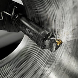

Silent Tools™ for turning
Overcome vibrations in internal turning
Reduce vibration with Silent Tools™ unique damping technology
Silent Tools™ is an anti-vibration technology that enables internal turning with long overhangs. Solutions are available to reach lengths of up to 14 times the bar diameter.
Productivity gains
By using Silent Tools ™, productivity gains of up to 50% for shorter boring bars and up to 400% for longer overhang lengths are possible.
