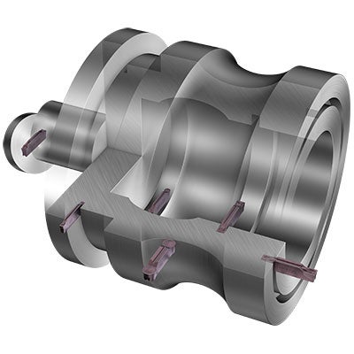

Application
  • Parting off, external grooving, face grooving, internal grooving and profiling
  • Roughing to finishing
CoroCut® 2 is a cost-efficient solution for cutting depths where two-edged inserts can be used. CoroCut® QD and CoroCut® QF are the best choices for larger depths of cut and CoroCut® QI is recommended for face and internal grooving in small diameters.

CoroTurn® SL cutting blades enable a wide range of tool combinations from a small inventory of adaptors and cutting heads.
Insert geometries
  • Grooving: -GF, -GM, -GL, -TF
  • Parting off: -CM, -CR, -GL
  • Turning: -TF, -TM
  • Profiling: -RF, -RM
  • Wiper: -GM, -CM, -CR -TF
