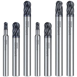

Providing an outstanding surface finish and unparalleled tool life, CoroMill® Plura ball nose is your first choice for profiling (semi-finishing to finishing) operations in titanium and HRSA.​
A six-edged productivity boost
Featuring up to six flutes, CoroMill® Plura ball nose offers market-leading productivity levels while maintaining uncompromising surface quality.​

Titanium (secondary application area: ISO M)​
  • Number of flutes: 4–6​
  • Diameter range: 3–20 mm, 0.125–0.750 inch​
  • APMX: 1.5×D​
  • LU: 3×D, 5×D​
  • Grade: T2CH
HRSA (secondary application area: ISO H)​
  • Number of flutes: 5–6​
  • APMX: 1.5×D​
  • LU: 3×D, 5×D​
  • Grade: R2AH​
Features
  • Newly developed face geometry to avoid unfavorable cutting conditions in the center​
  • Uneven tooth pitch for the best dynamic stability, avoiding vibrations​
  • Highly optimized tool geometries with up to six flutes ​
  • Dedicated grades for titanium alloys (T2CH) and HRSA (R2AH) with Zertivo™ 2.0 coating​
  • Specific edge preparation for the highest tool life and reliability​
