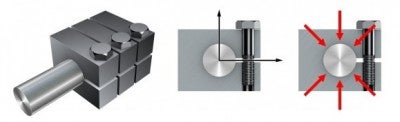

Long overhangs are most common for internal thread turning. When machining with long overhangs, it is especially important to mount the bar correctly to ensure enough clamping contact. Recommended clamping length is 2.5–5 × bar diameter (D), depending on boring bar design. This will result in a stable tool setup.
For best performance of the boring bar, the contact, design, and dimensional tolerance between tool and tool holder are important factors. The best stability is obtained with a holder that completely encases the bar. A V-type bar holder and cylindrical holder with screws are not recommended.
Holder that completely encases the bar
V-type bar holder
Cylindrical holder with screws
Cylindrical boring bars and adapters can be clamped in split sleeves. Large boring bars and adapters can be clamped using two split bearing caps.
Tool assembled with split sleeve
Tool fixed in two split bearing caps
