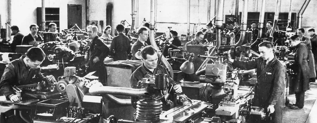

The development of the first commercial steel alloy is often credited to Robert Forester Mushet, who discovered in 1868 that adding tungsten to steel increased its hardness even after air cooling. This finding formed the basis of alloy development, leading to the use of tool steels. In the early 1900s, forming and machining metals was still very much a skill; highly skilled craftsmen used tool steel as a cutting tool material.
But as demand for mass production began to increase, particularly with sectors such as the automotive sector starting to take off, it became clear that tool steel wouldn’t be able to keep up. Its limited heat resistance results in softening at higher temperatures, particularly at the cutter-workpiece interface, making high-speed cutting difficult.
As a result, high speed steel was developed, containing more cobalt than tool steel. The additional cobalt gave high speed steel an improved hot hardness, enabling access to much higher cutting speeds. Faster cutting led to a boost in productivity, dropping overall product cost and ultimately was one of the factors that helped to make vehicles more accessible and affordable to the public.
